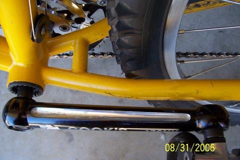

I've got a 127mm spindle in my 91 Yo for my 110/74 Cook's cranks and I have more than enough clearance. I don't know Cook's well enough to know what time period mine are so I have included a few pix. The drive side arm was beveled on the inside for frt. der clearance issues but the arms and the inner ring fit just fine.

Posts: 289
Click on each photo, brings it up larger
MikeNYC on this board should be able to give you the necessary spindle length...it was his auction I believe.
I'm running a early 90's CBR with a 127 spindle on a Yo FWIW
