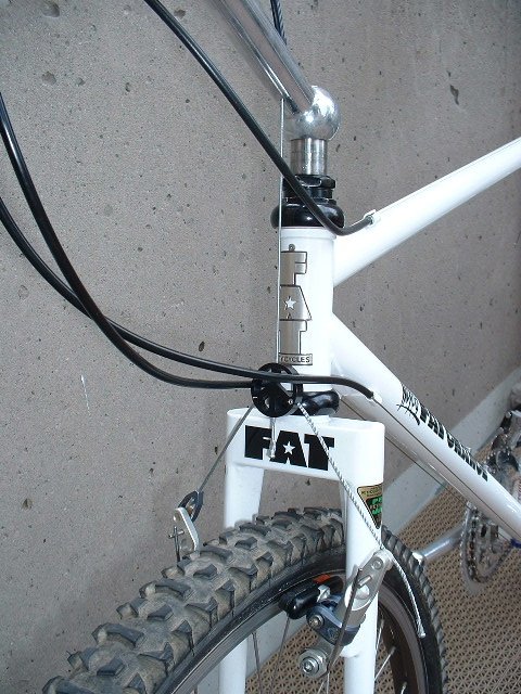

Hi Everyone (or anyone who cares...)
Here is my long awaited renovation project which is my 1990 Wicked Fat Chance frame, purchased on the super cheap last year from VeloCulture in taxi yellow and paired with a black Box Crown Fork that someone gave me for free!
Paint is by Vicious Cycles, which I'll be totally honest is beautifully done but has to be the most delicate paint job I have ever seen, it chips off if you look at it too hard - Fat City paint was WAY tougher!
The head badge was my own original design that was translated into sterling silver and hand made by Jen Green.
Parts list to follow, I just wanted to post the photos and get it out there...
*FYI The wheelset in these photos didn't work out they were 130mm rear spaced so I sold them and had a new set built up...will post them lower down...

The bike is sweet, I really like the combination of white and black. Love the stem and cranks, what sort of brakes are those?
Did you ask Viscious about the paint chipping? I have considered using them and would be curious as to their response. Did they do the decal too? How do they look up close?

I like the white. I like the box crown fork as well. Are those heavier than the unicrown forks? They look like they should be, maybe looks are deceiving.
Was Vicious able to supply decals, or did you have those already? I want to know what the brakes are too, I don't recognize those. I bought a Vicious fork with my recent Buck, and although they matched the baseline color well, they didn't get the red overspray/pearl highlights that the factory Team Violet has. In their defense, they didn't have the frame to work with, sounds like they matched it off of a jersey!

The brakes are WTB SpeedMaster Canti-Levers with Grafton Brake Levers, the levers are very light and cool looking, but I'm not sure that I'm going to stick with them...I may go with some Paul's instead.
I didn't call Vicious about the paint yet, I don't even know what their policy is if you're not happy with their work-but all I need to do is run my finger over the painted tubes of my white bike vs. my black bike (which was painted by Fat City) and the black paint is defintely thicker. The decals are clear coated and were provided by Vicious Cycles during the repaint and are original or probably made by that company in North Carolina, who apparently made the original Fat City decals. The Bike and paint looks awesome and I think that I'm happy with it, but once I begin to ride it, if the paint chips or scratches from normal riding I will call and complain.
Congrats, bt
Hi BT,
Thanks, I was always hesitant to get a white MTB but it's actually really nice looking!
I don't know if the Box Crown fork is really that much heavier then a Uni-Crown, but in my opinion, it may be stiffer but it's defintely a nice riding fork that absorbs shock very well for a rigid fork...The brakes are WTB cantis and they are really finicky to adjust and I'm not quite done adjusting them to my taste, but onece they're dialed in they're supposed to be great...time will tell...I'll let everyone know.
Yes, Vicious supplied the decals, clear coated them and followed all of my specific directions...I guess that they are able to order the decals from that company that originally made Fat City decals, as that place only sells to "the industry."

The story behind the free Box Crown fork is that I was shopping for a modern DH bike and I met this really nice dude via the MTBR for sale section and he was right in my hood and had like 3 of those Brooklyn Machine Works dual suspension bikes that cost upwards of $5000-$7000! Anyway we got to talking bikes and I told him that all I really ride are old school Fat Chances and he said "oh I may have something that you'll like" and he goes into his storage room and pulled a Box Crown fork out of a milk crate filled with bike parts and handed it to me and told me that it came on his 1987 Merlin but he took it off as soon as the first Rock Shox came out...I said "How much?" and he said "take it, it's yours!" I almost crapped my pants and wound up buying one of his Brooklyn "Park Bikes", but it just wasn't for me, so I sold it last year and then hunted down a Wicked Fat frame to slap that fork into and that's how this White Wicked came to be...FYI-That fork is the one in my avatar as well.
Thanks for the compliment on the eye for detail, I really like to make my bikes fit well, ride nicely and look good, which isn't always easy to do. Some people dismiss my bikes as wall hangers, but believe me they do get dirty, I just clean them off before they come back into the house and go back up on the wall

I wound up with 2 tiny chips from having a local bike shop install the BB and headset ;( one was a chip in the clearcoat on the seat tube but that one was still white, the other one was in the "chain suck" area and although it was tiny it was all the way down to the bare steel, one of the guys in the shop was ogling my frame and asking questions (after I paid of course) but when I saw the chip I yelled "You guys chipped my new paint" and he just slinked away...Not much you can do in that situation, but luckily my wife has enough nail polish that we were able to match it up perfectly! I'm going to sit the bike out on my terrace right now as the 85 degree sun shifts over and I'll let it bake for a few hours, thanks for that tip!
The black Fat Chance was actually originally powdercoated in 1988, but I had it sitting as an unbuilt frame that was NOS until 1990 when I went to build it up and I called Fat City about something else, probably BB bearings and they actually asked me to send it back to them to have the powder blasted off as they had problems supposedly with some frames rusting under the powder coat and while my frame was "bare" they had the gussets added to the box crown fork and the underside of the downtube...they said that they had to do some crazy process to get the powder coat off properly but then they used paint for the new black color...that's also when I got them to use the super old decals on that bike...They must've had some liability issue with regard to the powdercoat, does anyone know about this?
The seat clamp is an original 80's version of the Fat City seat clamp that somehow I wound up with an extra of, it's not correct for a 1990 Wicked Fat, but it looks cool with the black decals and black head set and it works...one less part that I had to buy! The bolt is a Control Tech Ti seat bolt, I don't typically use a QR on my seat.

The Bullseye wheelset in the orignal photos of my repainted bike didn't work out on this Wicked because I figured out that they were 130mm rear spaced, so I sold them on ebay and had a new set built up with some trusty Phil Wood (135mm rear) hubs and Velocity rims. I changed to some beefier Tommaselli brake levers and since the Cook Bros. Racing "older" school solid crank arms were hitting the front derailleur when the chain was in the big ring, I had to swap them with a set of "newer" Cook Bros. Racing RSR crank arms with the milled out back, along with a shorter bottom bracket spindle and black rings to match the spyder.
I think that this should be the final set up on this build...or at least I hope so!
Here are more current photos of what the 1990 Wicked Fat Chance now looks like:

Michael,
Great looking bike (no surprise there)!
Have you put any miles on it yet? How is the paint holding up?

Originally Posted by rick View Post
Michael,
Thanks Rick!
How are you and your huge Fat Chance collection doing?
No miles on this one yet, no excuses other then sheer laziness in addition to the issues with the wheels, brakes and cranks...But this bike is set up for riding and will be will ridden soon!
Regards,
Michael
