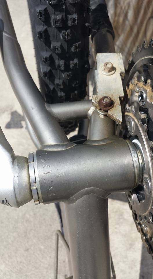

Hi, could anyone confirm my frame numbers please? I have 029Z07 on my yo eddy, is it an early one ? I'm thinking its a '90 but the Z is throwing me and there's no letter(s) at the end to denote the size (measuring shows it to be a s/m) although I've read a thread or two on mbr.com where other owners have numbers that don't quite conform to the norm....

Memory is getting fuzzier by the day, but I think the "7" says it's a 17" frame, which makes it a Medium. The 18" was considered a M/L and the next larger size in the family.

Thanks, would I be right in thinking the 029 points towards the 29th yo built that year?
#6 |
It would either be the 29th YO of the year or the 29th YO of that size of the year. I don't remember exactly what we settled on but it would make more sense to me that it would be the 29th YO of the year. I wasn't involved much in serializing the frames. That was already done by the time they got to my welding area. Hindsight being 20/20, I wish that I tracked every serial number that I welded on and what parts I did. We did do that for a short time but the practice fell by the wayside for some reason.

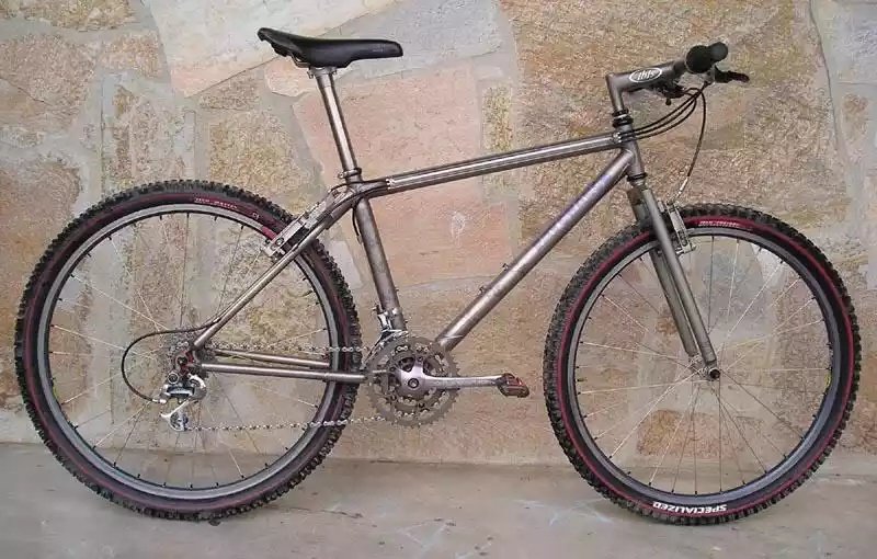

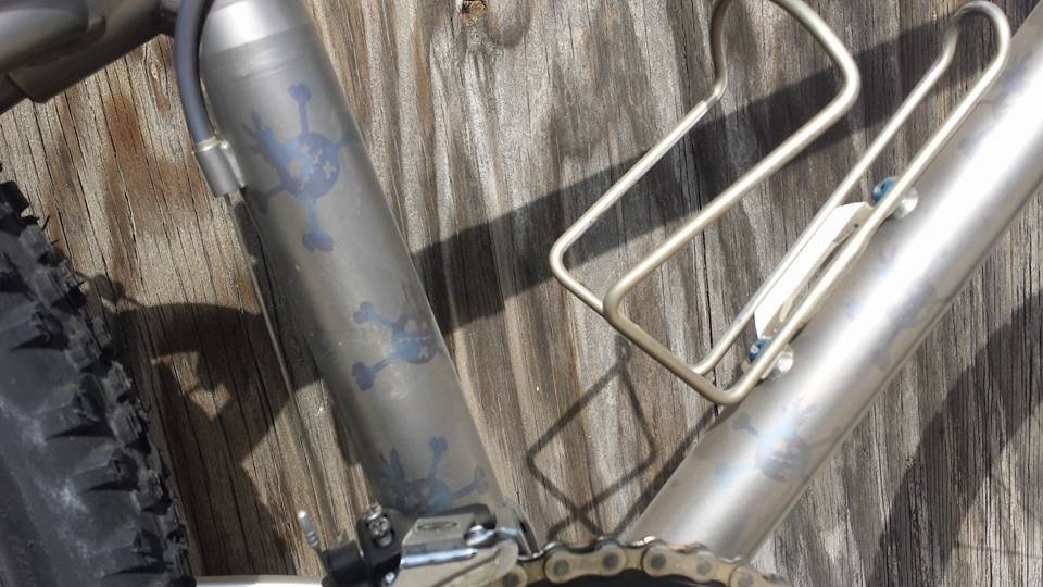

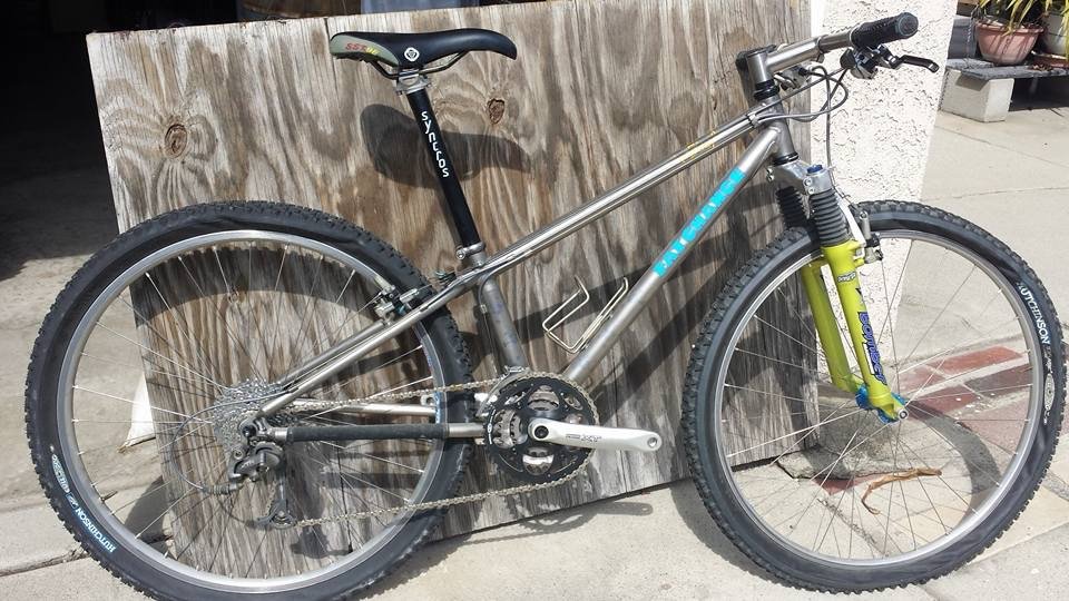

Yes ... fat ti ,serial #050t3m..... just found out yesterday that it's a team, one of three known ,or possibly 4. Leni fried anodized yo eddys and name graphics. I found a photo of one with vinyl covering the name on the down tube,supposedly for better photography. Yo eddy puppets on top ,Down and seat tubes. Also various positions and number of puppets. From an auction in Germany,in 2012, one bike sold at $4150. And I remember 4 to 6 weeks later one sold at 4250.usd. I suspect they may be the same bike. So that brings it back to 3. So rare it's nearly impossible to find much more info. My bike is one owner. I ran a shop in Cedar Rapids,Ia ,and built mine up with the only Campy group I could find from my distributors,mostly Euclid last gen. Except a mirage/racing triple with 24-53 rings.I wanted an overdrive. Top gear something like 128.5 for the rockys .my bike is also the lowest serial# of the three. I ran the first gen AMP fork that was great steering and comfortable. Honestly , I never rode it off road and I've owned and sold over 1500 bikes so much to compare.I prefer ht. I'll try to load a couple pics of the other bikes but mine is so buried I can't get to for the last 10 years.sorry.someday. I mounted the BOI and rode the parking lot is all,so no miles there. Maybe a couple hundred o the bike.I've tried to keep it free of scratches and no chain suck. I run 4 front,8 rear.indexed thumbies. And about Ragbri,yeah! about 24 of 44 years. Sometime it's the best times of your life. Great way to see the state off the interstates. I like the various country terrain. People roll out the welcome mat everywhere. Traffic is controlled well for bikes and locals.lots of food and music.I've always bikepacked since the 60s ,light and fast.now I see more self contained riders again. Others ride in groups with rv and sag support. Shows you what your made of,but people return for more.Riders from around the planet more every year. I used to know hundreds but last time only saw a handful, yet some claim 30,000 peddlers on some days.It's a big deal. 10,000 passes sell out in minutes each year. I just go and ride outlaw,but I behave .

![]() ![]() Ex Team race bikes need to be discussed in depth. Really like the diy anti chain suck piece. 100% agree. The Ti FATs are the best retro bikes ever made - end of. |
