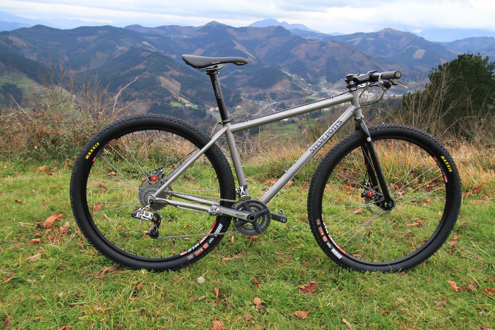

Look at a Steve Potts 29er…with a type 2 fork.
http://4.bp.blogspot.com/_QIN_7pXAfJ...0/IMG_0044.JPG
if you are not looking to put suspension on it, you could run a shorter fork with just enough clearance to keep the BB lower.
it would probably be a fast handler.

go for a 26/ 650B combo. the BUck is designed for 410mm forks. Go w/ a 425mm and you can fit a 650B wheel... w/ discs upfront.

Oh man that thing's a beaut' !!
