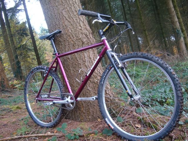

I brought this bike last year off Ron Andrews. It appeared to be pretty much original apart from saddle and tyres with Suntour XCD . I built it up (see pics)with a new saddle, amber walls and a Hite-rite,it looked great, but it was missing something, it was an ok ride but was in the shadows of my Yo's, Monster,Wicked etc.The components were pretty worn out so i stripped the bike down and up it up for sale.I had a little interest in it, but it didn't sell.
I'm glad.
I persuaded Kaiser to part with his Groovy forks and IF52 supplied me with some Luv handles and a zooka after my post on here.I brought a second hand King headset of Retrobike,then I had everything I needed for the rebirth of my Fat Chance.
I have replaced the worn out components with some nice Mavic 231 rims laced to White industries hubs, the rear being an eccentric Eno hub with a White Industries 18T coupled to a 34T up font.Thist set up has transformed this bike into a great little Single speed with a much nicer feel to the ride, could be a slightly slacker head angle or the smoothness of the king and reach of the luv handles? who knows .
This is perfect, maybe try a slightly shorter stem at some point but its now so much fun.Yes I know it has Vb-rakes on , but I ride my bikes hard ,so the extra stopping power is much appreciated!
hope you like it

great bike for sure and glad the changes have made a difference to the ride- still don't like those forks and well done on getting them off of kaiser- thought he was getting buried with them!
Cheers, there's still time for h to be buried with the forks, I've still got the original fork which i'll keep.Not a fan of the Groovy fork ? What don't you like , the appearance ? Im a fan of them , the way they look and ride

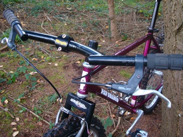

I have a groovy fork, they rock, yours looks really long - I think mine is 395mm a to c. I would also shift the bars so they angle level or slightly down - not upward like prongs
this will give your wrists a break...and relax your position with the sweep back.

I wasn't a fan of the Groovy fork at first until I saw one in person at Rody's old shop. Photos don't do them justice at all. They are very nice looking in person.
Of course all of this is just my old man jaded opinion
happy trails!
Jim
I moved them up as they were a little uncomfortable on the climbs, may have another go with them pointing down.
