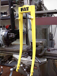

I think your 1989 Wicked needs a fork like that
(pic is from groovy cycle)
and not a YO or BOI fork
...you can also ask this mate -> http://www.gebla.de

And Nader. That roller cam box crown fork is one rare bird !

And I don't think Rody at Groovy is handling Fat forks and repairs any more due to his other work load, but you may want to send him a PM.
I know where there is one of those that is most likely available and I'm not talking about that particular yellow fork which happens to be mine
