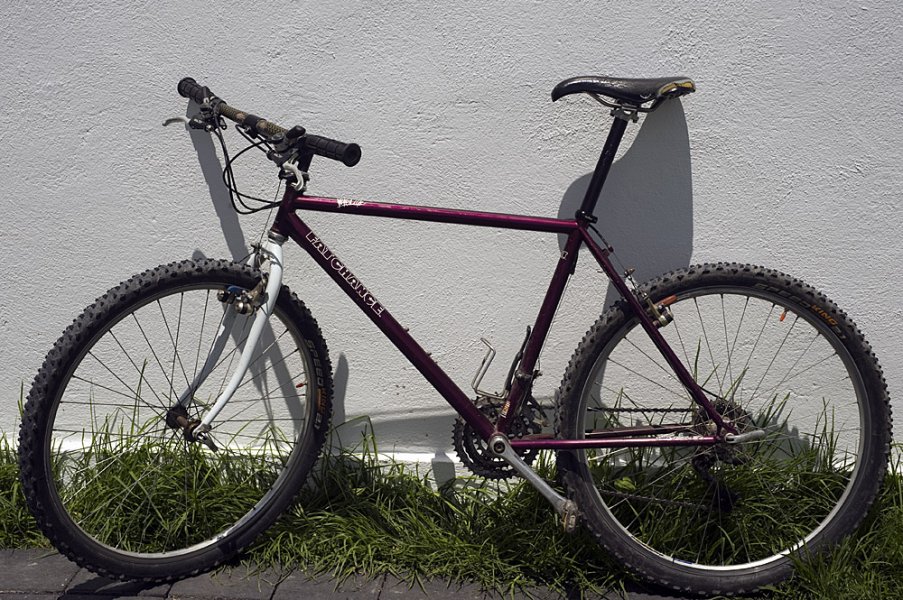

That's my wicked. I have a 31.5 inseam, no shoes.
