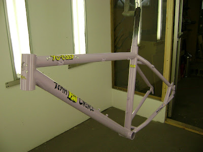

The PPG paint codes everyone has always wondered about:

AB,
No offense taken. Considering the "original" formula was applied to only one frame, I agree, it will never be the same there after.
However, as time wore on and the color was sprayed more often, there was a narrowing of hue. I made my mix up after having 4 different shades on the table at once and then hitting the mean.
Would most people be able to tell the difference between any of them separately, probably not. But as one who pursues this beyond a hobbiest level, I believe the new mix is passable
Nothing is never as grand as in our youth/memories, but is sure is nice to reminisce.

And, as promised, the formula for the Team Violet Fat City paint. Take this list to your favorite supplier and you to can have the elusive color.
For a matter of information sharing, I use PPG paint, DBC series, listed by weight based on a pint formula...
FCC TEAM VIOLET:
DMD 1684 White 668.5
DMD 1679 Red 40.3
DMD 1683 Black 17.7
DMD 1676 Blue 8.0
DBC 2002 series clear 6 oz with 3 puffs of Sunset Red Pearl overcoat
There y'all go...hopefully we'll keep more vintage rides looking great for decades to come.
