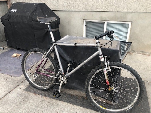

Here's a quick pic (I have original fork as well)

Honestly don't remember all of the details but the story seems to be pretty solid. I think he originally only wanted to go up to ML on the sizes.
I would not have been a part of any conversations regarding building the larges, that would have been Chris' deal.
Almost certain that I would have welded them since I did nearly all of the 10ths. I say nearly since I cannot accurately recall actually doing all of them. Dave Blakeney and Sue Kirby could have welded a couple of frames or more likely welded some subassemblies. Patrick probably welded the forks. He did quite a few of the Yo forks. I really didn't weld too many forks through the years.
Nice find, take good care of it

Thanks for the reply. The only thing I see noted in the serial book next to these bikes is the date of 2/1/93 and the initials WB. The serial number for this bike is 001A3L, not sure how that plays with the build date?
I liked the 90 Yo I had, it was a solid go to for everything. But, I just didn't love it more than some other bikes which is why I sold it. I've been itching to try a later model year Yo and this 10th is a part of the way there.
The thing I want above all is a Large Ti. Looks like there were around a dozen made in 93 so that's a good sign. I'll take a 94 if I find one, but haven't seen one yet. I have the fork standing by though.
